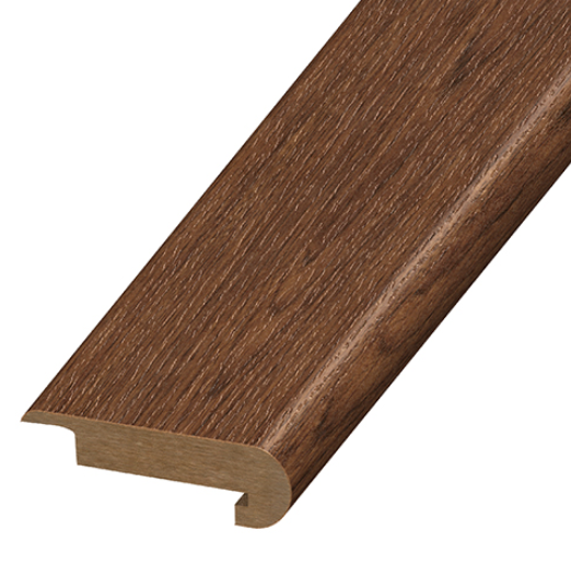

Stairnose
This is probably the most obvious of them all of where you would use it. The sad thing with the stair nose that they sell with laminate is they never look good. They just have a poor design to them. If you do need to use a stair nose, there is almost always a little modification that needs to be done.
You will need to cut the sub floor back to the riser of the step. This will give you the best look. Otherwise the sub floor will show because the lip where the stair nose ends is not long enough to cover the sub floor. If there is carpet on the riser, it will be difficult to make it look good when you try to cover that exposed sub floor.
So just trust me and cut it off.
One more suggestion, never put laminate on your stairs. Just buy real wood treads and install those. Laminate on stairs is not as ideal as you think. The stair noses are spendy and they are just junk. I could go on and on about this and someday I will do a post on it.
