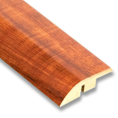

2. Reducer
Used where your plank steps down to a bare subfloor or thin sheet vinyl/linoleum. It can also bridge a drop from thicker tile down to your plank (the lip covers the tile edge while the ramp rests on the plank).

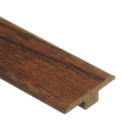

3. T-Molding (Never Use on Carpet!)
Used where your plank meets another hard surface of roughly the same height (tile, hardwood, or another plank floor). NEVER use a T-molding where plank meets carpet! Carpet is too soft to support the wing of a T-molding and I guarantee it will snap.

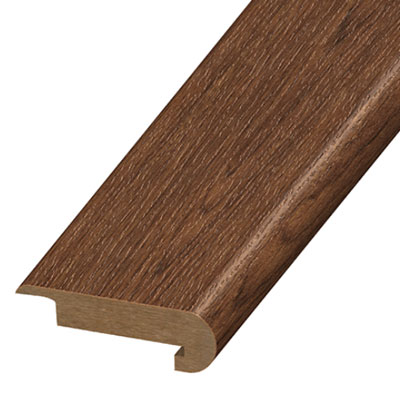

4. Stair Nosing (Flush vs. Overlapping)
Use a Flush-Mount Stair Nose ONLY on individual stair treads where planks are glued down. Where a floating floor ends at the very top landing of the stairs, you MUST use an Overlapping Stair Nose so the floor can expand and contract safely!

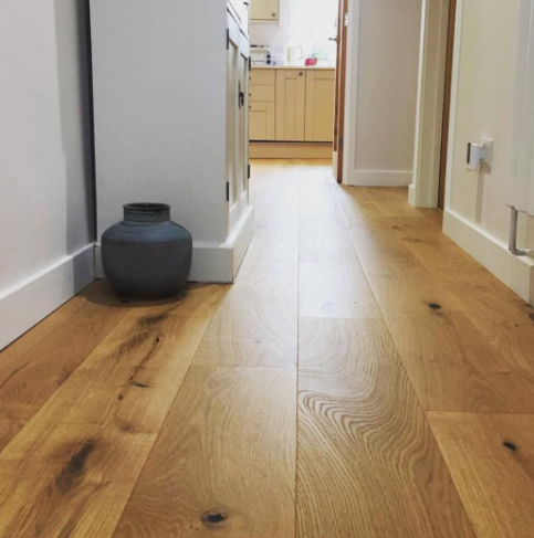

4 What Direction Should Your Plank Run?
Because you are installing a floating floor—not nailing down hardwood—floor joist direction does not dictate which way your planks run. Instead, plank direction comes down to two things:
- Run planks lengthwise down the main hallway: In almost every home, the hallway is the central visual focal point. Running planks the short way across a narrow hallway looks choppy and increases the risk of buckling. (If you have two hallways running opposite directions, pick the main entry hallway you want to look best!)
- Plan your direction to avoid doorway transitions and minimize working backwards: Your planks have a tongue and a groove. Sliding the tongue into the groove (working forward) is fast and easy; inserting the groove onto the tongue (working backwards into a room or closet) is slower. Don't let working backwards scare you—I share simple tricks that make it easy—but picking the right starting wall keeps it to a minimum!
