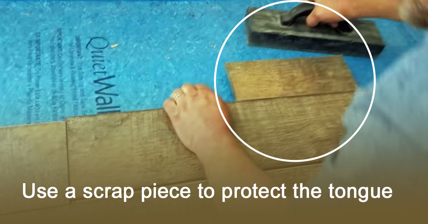

Cut a Scrap
If you cut a scrap of plank and use this to beat on with your tapping block, then the edge of the plank you are installing will not get damaged. You can also use this same tip when installing all of your plank.

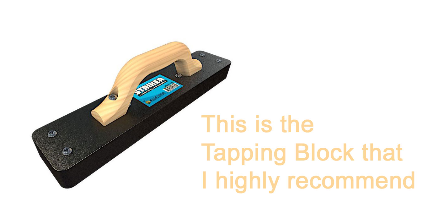

Get a good tapping block
A good tapping block cannot be found at any of the big Home Improvement stores. I really don't know why they haven't been providing quality tools for plank installations, they just haven't. Click Here to see where I get it.

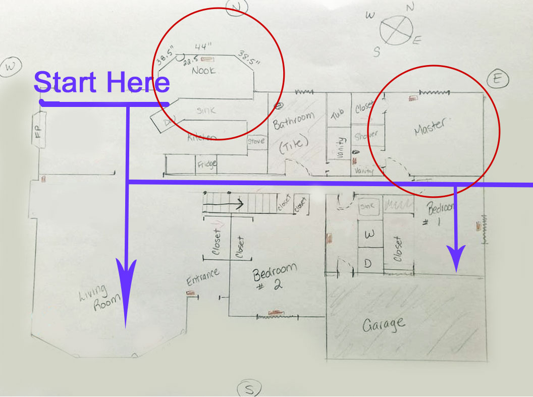

Many people these days are installing plank all throughout their entire house. This is where you need to get creative and come up with a good plan on where you should start. If you do this then you might be able to avoid having to work backwards in some of the areas and maybe even none at all.

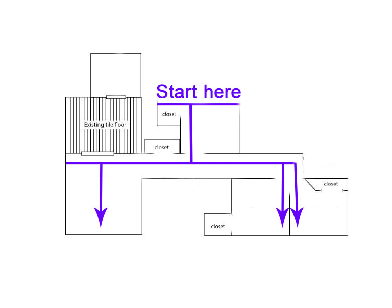

Here are some examples of some layouts and how you can AVOID working backwards
Here is what I would do to AVOID working backwards

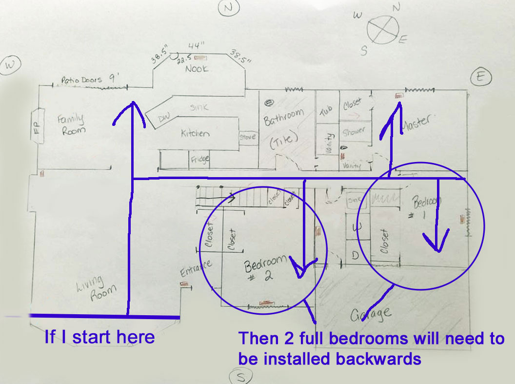

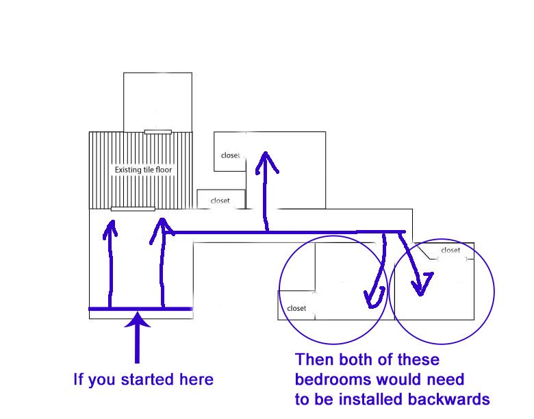

Here is another example
If I start in the Kitchen there is One Bedroom and the Nook to install backwards
Sometimes it is a toss up on where the best place to work backwards is. The last one I just showed you was a tossup. You might have furniture to consider or maybe the order of what you remodeled first. There can be many factors brought into your decision, you just need to at least think about it in the beginning. By doing this you are saving yourself a lot of headaches.

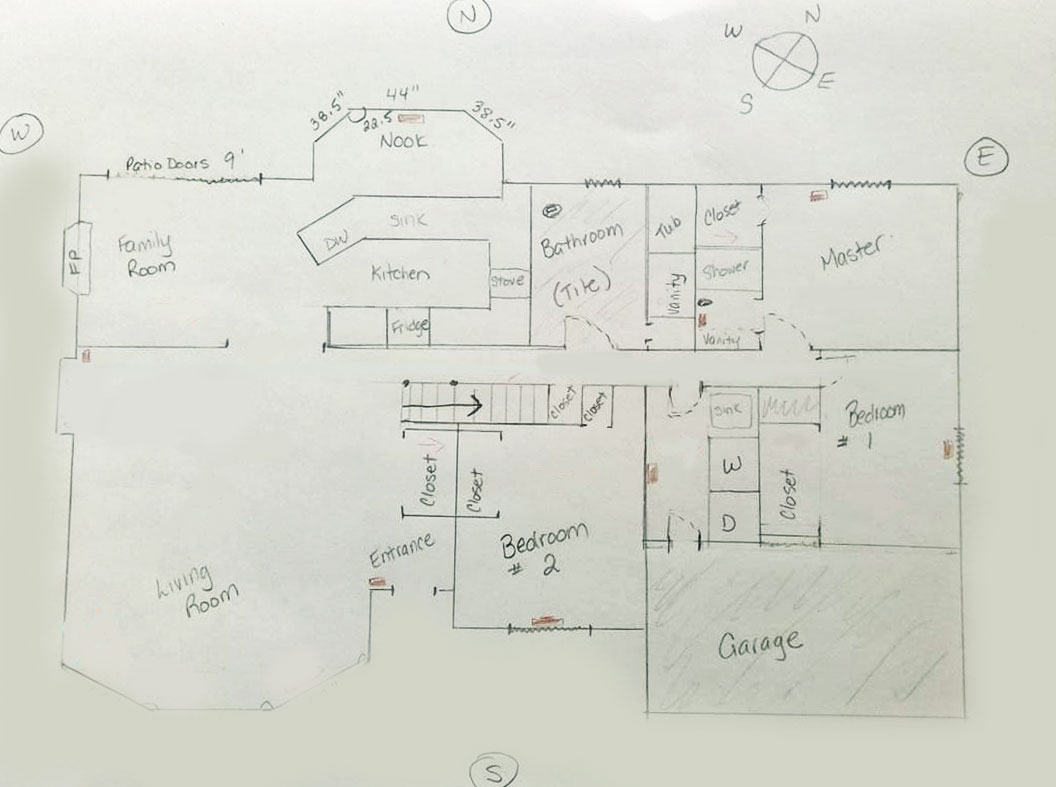

I can help you with your layout and help you decide where the best place to start would be. You can share a drawing with me, we can talk it through and make a great plan. As a member of Laminate University you will have access to these benefits and plenty more. Join 100's of other DIY'ers just like you and let's make a plan.

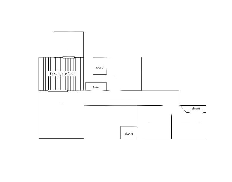

My job is the following:
Hallway in center of house with 5 transitions where I will put in the T mouldings to terminate and NOT run the plank into these room except for one very small closet. (bath and mud room already have plank of a diff color)
The living room/kitchen is one big space with an island.
Friday is self leveling day and trying to figure out where I will start. I can share a simple drawing and dimensions Fri morning.
